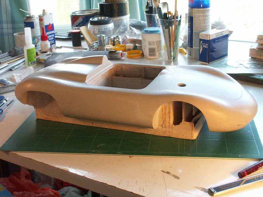

Hello Guys,
Sorry for my complete lack of Dutch...a typical Englishman! :D
I am very slowly building a 1/8th scale model of Carel Godin de Beaufort's Porsche RS60 (chassis number 055). This is the master for the body, taken from measurements of his car. Hope you like and let me know if you want more photos. Build is veeeeeeeeeeery slow I'm afraid as I'm making other models too!

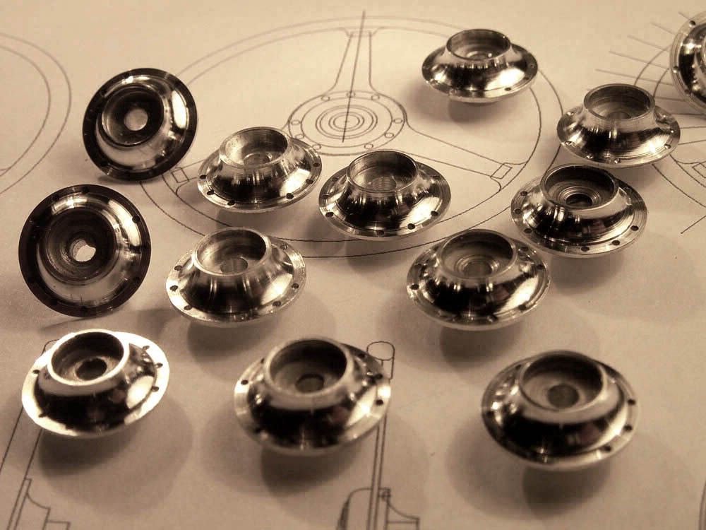

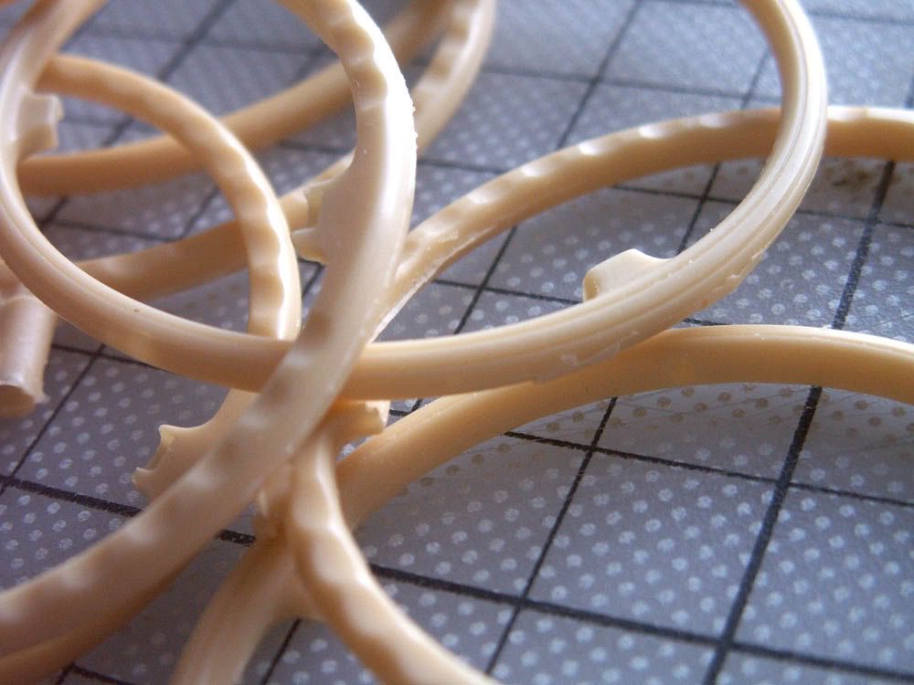

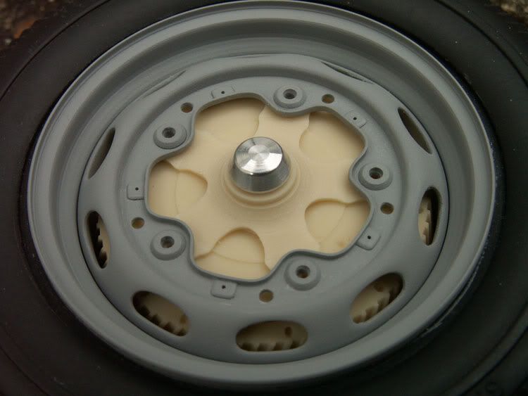

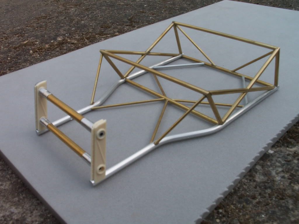

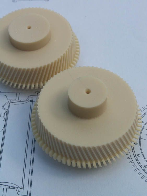

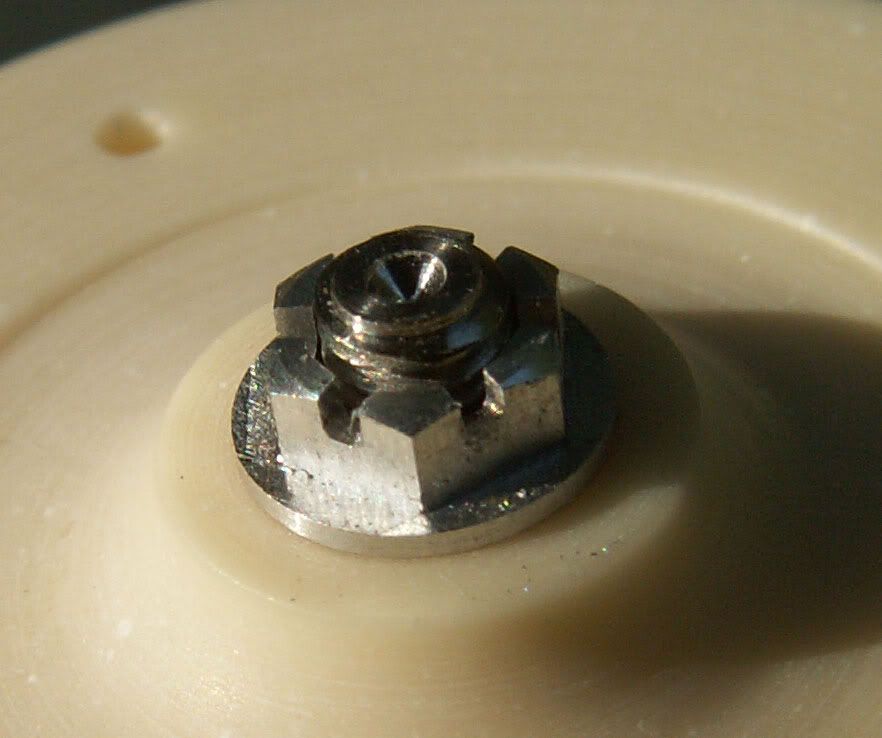

Enkele foto'S:
Geribde remtrommels
Achterste naafmoeren
Voorste trommel en Porsche 15" wielen
zn. onderstel; landingsgestel
